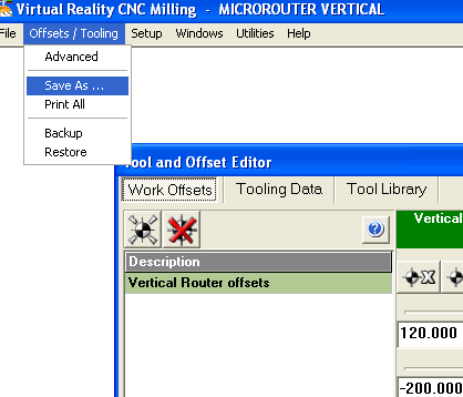

Open the work offset editor - the Offsets / Tooling menu should now appear on the top menu bar as shown.
Select the option "Save As..." and save the offsets file to a location on the network, which you have read / write permissions
