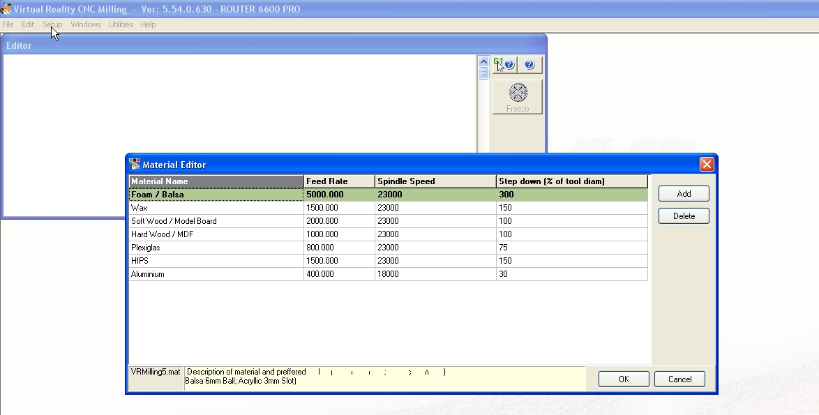

Post by Steve » Thu 23 Jan , 2014 12:56 pm
How are you creating the program? If using the DXF import or quickCAM 2D design then the material library in the VR Milling will be used.
Make sure you are running the latest version of VR Milling as easlier versions did not have aluminium in the material library.
If you are manually programming have a max depth of cut 30% of the tool diameter and Feed Rate = 400, Spindle Speed = 18000
6600pro materials.jpg (174.75 KiB) Viewed 9181 times

If you don't have the PRO machine selected or are generating using QuickCam 2 D Design on a computer without VRMilling installed then no ferrous materials are shown in the material list.
