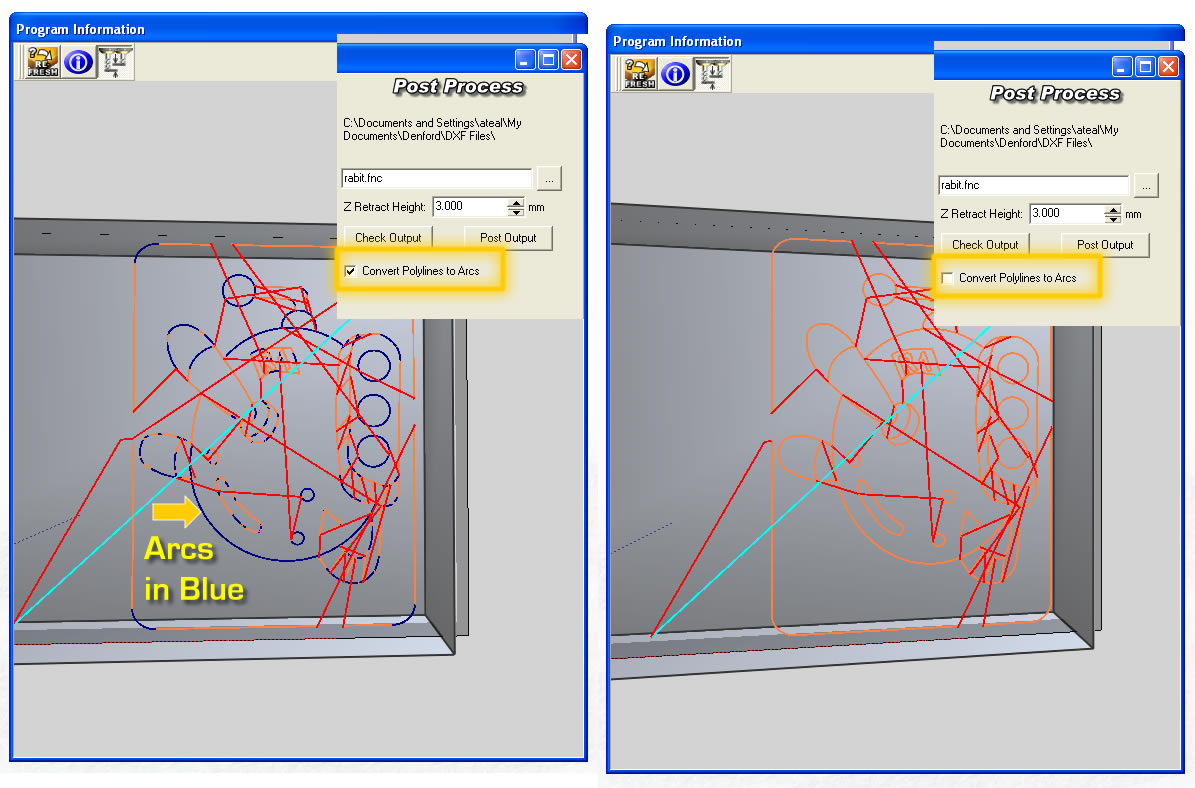

We can reproduce it here. The issue is to do with the way the CAM wizard tries to recognise arcs and is converting the large curves (shown in attached image) into invalid arcs.
v5.39beta milling has fixed the problem, although you still get an arc which is not true to the original curve, so the option to turn off polyline to arc conversion has been added in the final window of dxf import (see screenshots)

- DXFImportRadiusError.jpg (176.17 KiB) Viewed 6349 times
