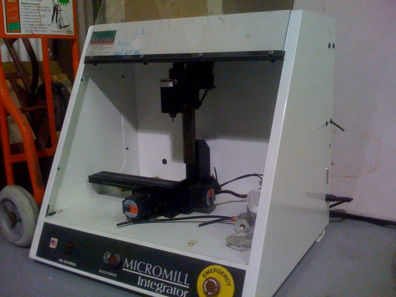

I purchased a used Denford MicroMill "Integrator" and I don't think
it's coming with software, and the condition of this thing (working?) is
questionable - how do you recommend me testing this thing(the
electronics)???
And, could anyone give me a good summary as far as what software I need to use this machine successfully.?..
Thanks to all, and for any information given!
Brian

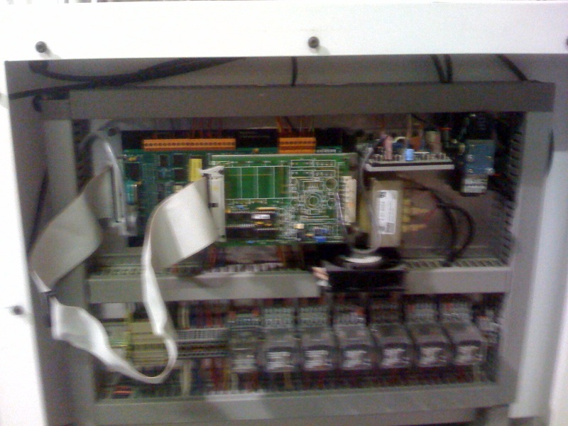

Bad picture of the black chassis
thanks for your reply, I've included some photos of the system.
- Electronics
- photo2.jpg (128.51 KiB) Viewed 9062 times
- Integrator cabinet
- photo1.jpg (144.72 KiB) Viewed 9062 times

as for which software, what does it say on the eprom which has a yellow label on it ? at the top of the box, behind the daughter board which has a big ribbon cable coming out of it.
viewtopic.php?t=1898

Got the # off the chip.
The Yellow tape label has the following:
denMINT
2.0.B10/S/B19-JD5
Bar Code (board) OC00193067
The main driver board, says SMARTSTEP/3 (OC00197356)
The main driver board has 8 orange screw terminal/connectors (if that helps ya)
There's also another third card that sits above the main board, and the controller card. This board said "OPTIMISED CONTROL LTD (issue 2)..
Software-wise, what do I need to communicate with this system, and I guess, could you give me a summary of the software needed.?.. (I know I obviously need a CAD program, and a CAM as well, but does Denford have the g-code intepreter/machine control, similar to say MACH3, etc)
I was also hoping to be able to get a users manual/technical manual so that I can debug this thing. Maybe a signal diagram (in's and out's)???????
schematics maybe.?
Thanks for your time and assistance!
Brian
denMINT
2.0.B10/S/B19-JD5
schematics maybe.?
Brian

Hi There,
Talk to Denford Inc (See details below) The cost of replacement software will not break the bank for you rich Americans
and you will have a good machine at the end of the day. We will always help with Technical problems wherever we can. As a starting point what does the 7 segment display on the control board ? a "2" or and "8" are usually good signs.
