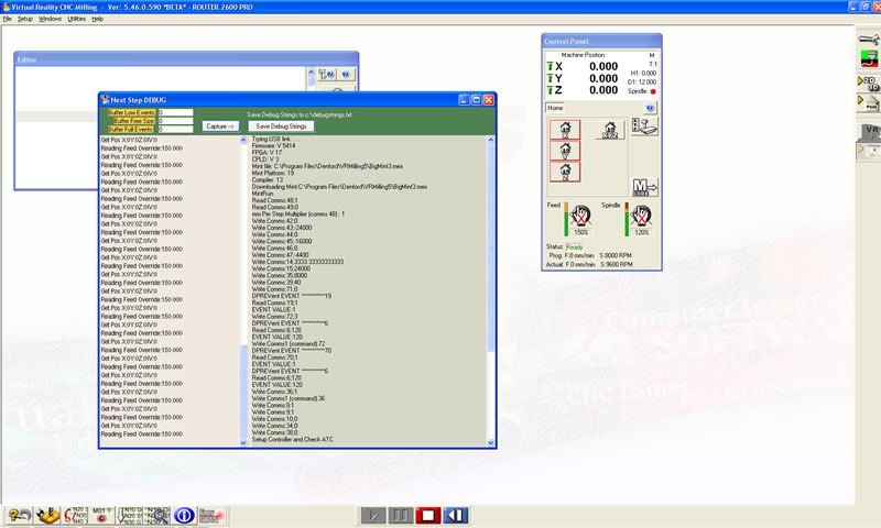

Post by Denford Admin » Thu 15 Sep , 2011 11:07 am
fyi the debug screen looks like this:
