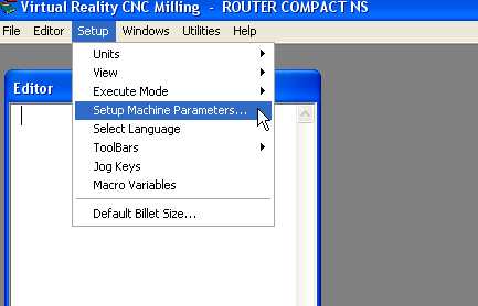

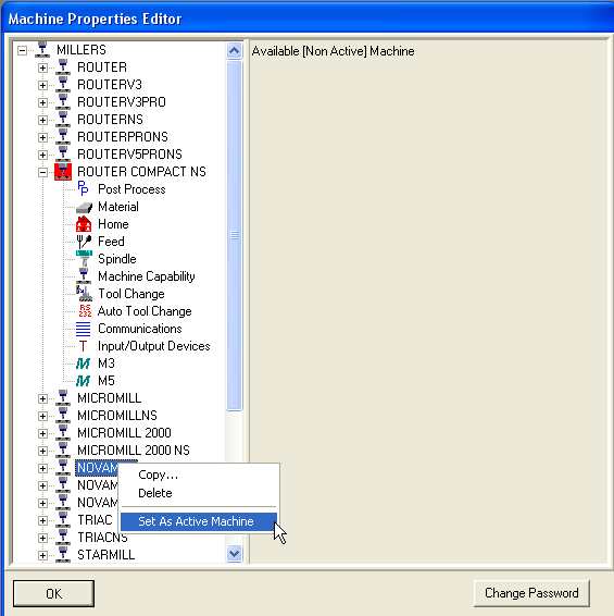

The second problem is simple. When you install the software you are asked to select the correct machine type. The Microrouter is the first in the list. It is simple to change the machine type and to work out exactly what you have check the plack machine label.
I assume you have VR Milling 2? You may wish to consider upgrading to VR milling 5. Follow the link to see why.
https://www.denfordata.com/projectimages ... lling5.pdf
If so the way to change the machine type is to select Setup option on the top menu bar. Then select the Machine parameters option.
You will be asked for a password which is "denny"
You then have a list of all the machines and can right click on the NovaMill and then set as active.

Post by Steve » Thu 11 Sep , 2008 9:58 am
Some screen shots for above.
