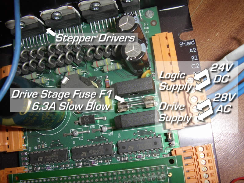

If the axes do not move, but the control is powered up and connected to the PC, then it could be:
Emergency stop contact is not allowing power to the drives
One of the fuses has blown (F1 in particular)
The input voltage from the main transformer is too high/low
Check that you have 24VDC and 28VAC on the connectors as shown here:
If this all looks OK, then there must be a drive / drive PSU problem.
