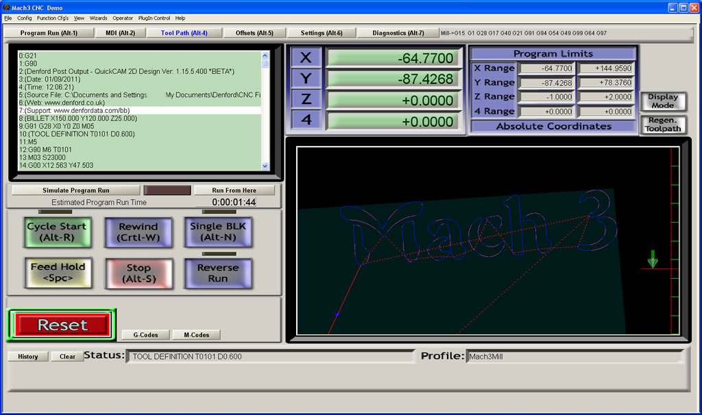

We haven't really been asked much for one, but I have created a basic one here...
Mach3.ppl
(1.73 KiB) Downloaded 1569 times
As you can see, the simulation in the demo version of Mach3 appears to work, but it's never been tested on a machine.
(the example in the screenshot was created in QuickCAM 2D Design and a follow toolpath created)
Drop the file here: C:\Documents and Settings\All Users\Application Data\Denford\Posts for Xp/2000
