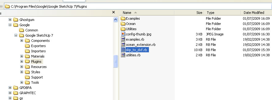

Then install the plugin available here: https://www.guitar-list.com/download-sof ... dxf-or-stl
(at time of writing, the file was skp_to_dxf.rb)
Save the file into the SketchUp plugin directory which is normallly here: C:\Program Files\Google\Google SketchUp 7\Plugins
Then....

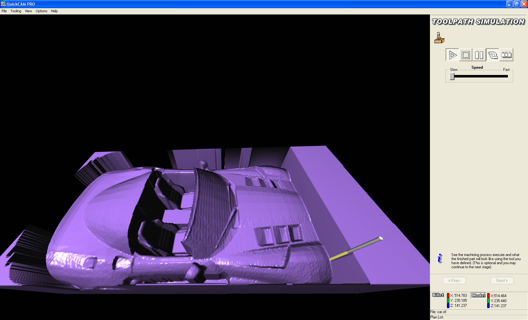

Re: Creating .STL files from free version of Google SketchUp
... load up the .stl file in QuickCAM 3D or QuickCAM Pro and create a CNC toolpath
