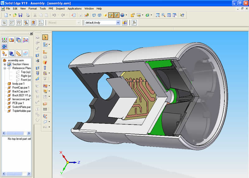

I used Solid Edge to design all the components we were going to need.
This allows me to see if everything is going to fit, and to create 2D DXF files from which I can create cutter paths for the PCB's and aluminium body.
The educational version of Solid Edge v19 is now available from Denfords - see here:
https://www.denford.ltd.uk/index.php?opt ... &Itemid=30
Assembly showing the major components that would have to be manufactured.

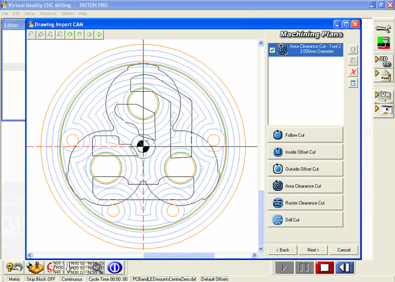

VR Milling 5 is the Denford machine control software:
https://website.denford.ltd.uk/software-menu
Apart from controlling the machine, it will also act as a 2 1/2 Dimension CAM system
It allows you to import a DXF or Gerber PCB file, and create cutter paths using strategies like raster, offset and follow.
I used this feature to create both PCB's and the milling of the Luxeon emitter mounts.
Unfortunately I didn't have access to a lathe, so had to get another friend to do the turning for me.
The DXF from Solid Edge imported into VR Milling 5 and offset tool paths created. Note how it allowed me to re-position the drawing datum to match my machine datum (centre of the billet)

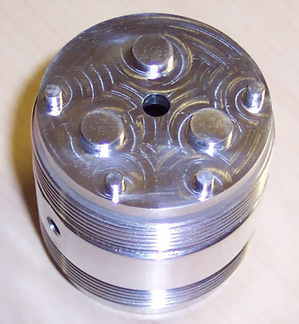

The main light body machined on a Denford Triton. I used an old chuck mounted onto the table to hold the part in. Finding the centre was a bit painful, but once done, I could go back and make more very easily.

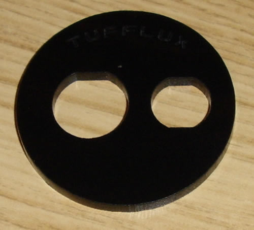

Having access to a VersaLaser was also great - I could knock out the acryllic end plates in no time from the DXF files.
https://website.denford.ltd.uk/machines
I used some 3mm black for the rear end plate which held the battery connector and the mode pushbutton.
Some 3mm clear for the front lense cover - I tried perspex but found it tended to burn and melt around the edges - I would really have had to machine this on one of Denfords routers.

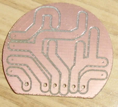

For the PCBs, I used a new Denford Compact 1000 Pro router.
I actually tried the new metal cutting option out, and managed to cut the same part in aluminium (as above) - cutting in aluminium with a 25000 RPM motor proved to be suprisingly accurate - you just have to take smaller depth cuts.
Again, using VR Milling to create the toolpaths, I created one program to trace around the tracks, and spot the holes I needed, with a V - point engraving cutter. Then another program to cut out the PCB from the board with a 3mm slot drill.
The BUCK PUCK mounting PCB -30mm Diameter - (which held the PIC micro on the copper side - "surface mounted" - lol)

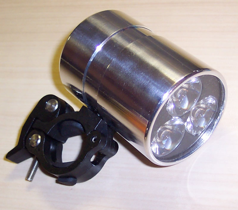

Here it is with all the bits assembled:
If you want to know where I got all the bits then I'll dig the suppliers out and post them on here.
Parts I had to buy:
14.8V 4000mAh Li-Ion battery and charger
3021-D-E-1000 BuckPuck with 1000mA output - External Controls
PIC Micro 12F675 - to control the Buck-Puck constant current driver so you can dim the lights (they are way too bright for road use and you'd probably get arrested using them)
3 times 3 Watt Luxeon Emitter Led - LXHL PW09
3 way collimiter lense holder
3 off Carclo optics lenses
1 off handlebar mounting clamp
wires, pushbuttons, connectors, acryllic and single-sided circuit board.
It doesn't sound much, but the cost of this lot was well over £150, however, the results were well worth it !
The finished light - perfect for night riding !
