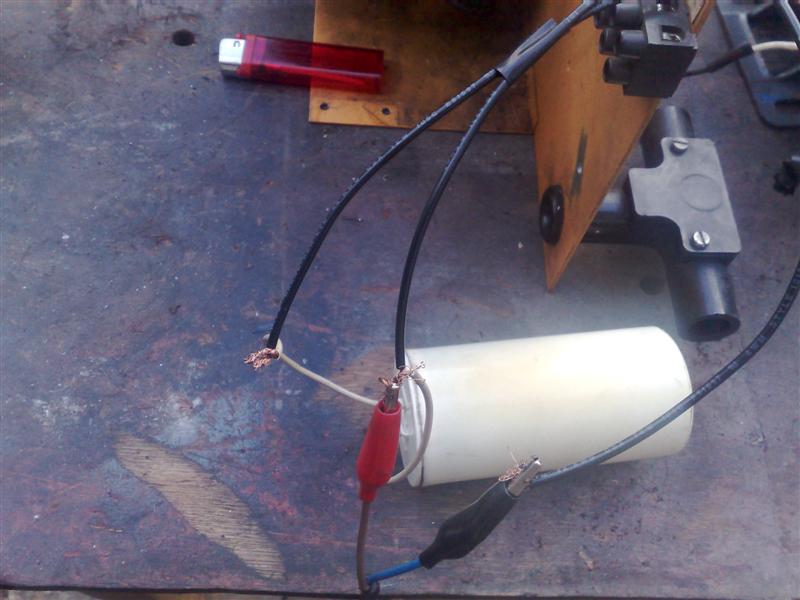

You're using the boxford motor as an idler for a rotary converter, and startin it on 240V with a capacitor?

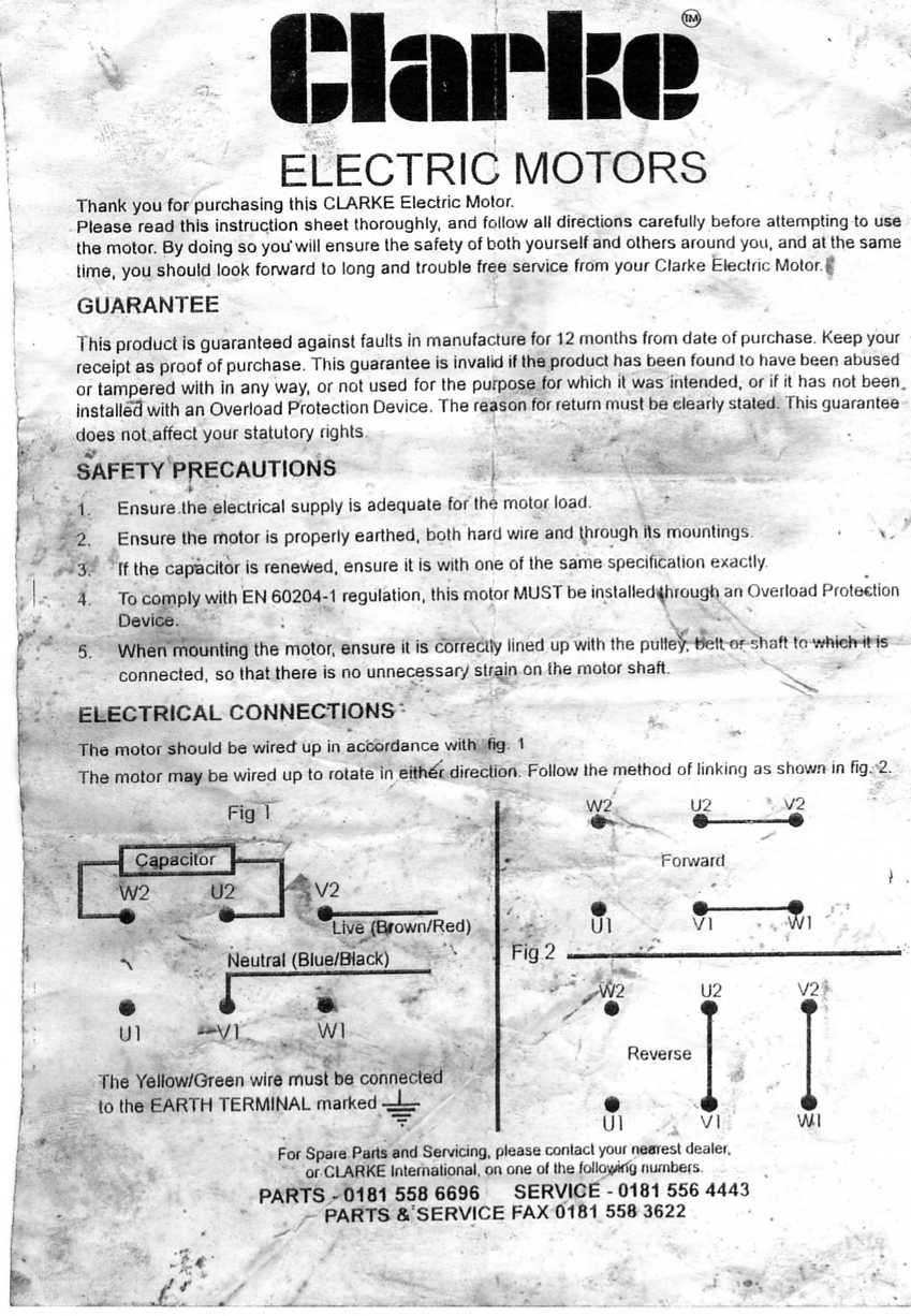

ITS not set up in my lathe yet ? but i will upload a photo of what am doing!! I have attached this off the motor i have bean using its a 240v clarke motor! now will i need 4 wire's form the motor to the switch for f/r?

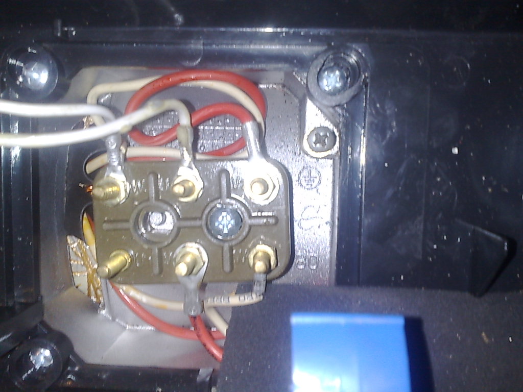

this is how i had it

Post by graham4877 » Sat 20 Jun , 2009 22:51 pm

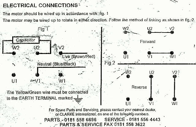

pete is the top of you single ph motor like this? if so how did you wire it up?

Post by Pete. » Sat 20 Jun , 2009 22:59 pm
Naw mine was totally different and older. The instructions look pretty simple though. Looks to me you wire up the power to V1 and V2 and use the reversing drum switch to make the fwd/reverse contacts in the diagram below.

Post by graham4877 » Sat 20 Jun , 2009 23:26 pm
HI pete as in live to v1 then live to v2 then neutral to w1 &u2? anyway i fitted the boxford motor and it vibrates like hell and wont get up to 1400 rmp think its running at 800rpm max! how did you wire out to your motor did you just use the a b c block and have the two neutrals in one?

Post by Pete. » Sun 21 Jun , 2009 12:00 pm
Re: the single-phase motor. If I read this drawing right you wire the power
to V1 and V2 (240V mains) via the breaker. Then you wire your drum switch to
connect terminals U2 - V2 / V1 - W1 for forwards, and connect U2 - V1 / V2 - W1 for reverse.

First thing you gotta do is map out the contacts of your reversing switch. You need it to be in DPDT
style with U2 and W1 as the poles and V1 and V2 as the throws.
