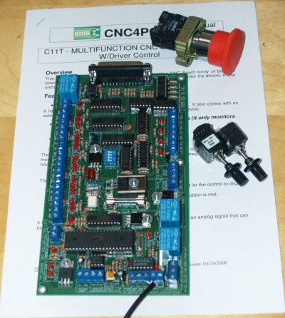

I bought a break-out-board (BOB) from CNC4PC which is fully opto-isolated and includes a 0-10v analogue output to control the spindle.

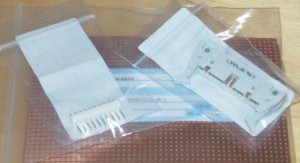

The plugs/sockets are all available from Rapid Electronics individually. Most other suppliers insist on you buying in multiples of 5 or more.
I bought a square of strip-board on which to build the interface - only because it's easy. (and nobody will be able to see it!)

I wanted to add a Manual Pulse Generator (MPG) for using the lathe in a semi-manual mode. This is useful for simple jobs like facing off a bar without writing code. The pendant controls I found were nice - but mucho expensive! I found some Bourne rotary encoders on eBay for £10 each - so bought a couple. These will control X & Z directly via Mach.
The BOB doesn't have sufficient inputs for two MPG's - so I bought a cheap Parallel card for the PC just for that.
CNC4PC board + MPG's & E-Stop button

Rapid Order contents

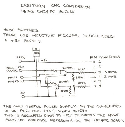

Home Switch interface
Mach Conv 1.jpg (32.08 KiB) Viewed 44669 times

The Home switches were inductive and needed an 8 volt supply - so used a 7808 voltage regulator.
It turned out that the built in 24v supply was too noisy. I had regulated it down to 12v (for the spindle reference) and 8v for the home switches - but both were all over the place. I used a 24v regulated supply (from eBay) instead and it sorted the whole thing out.
I wound up copying the original circuit for reading the home switches - a single transistor acting as an amplifier which 'pulls down' an input from 5v to (almost) 0v. Same sort of thing as the drivers for the stepper boards with slightly different values.

I think i have sort of figured out the homing switches, But what is the value of the other 2 resistors on your diagram?
You say you pinched the basis of this from your denford manual. Is it almost exaclty the same as in manual?
Just wondering as I have looked at the similar circuit in my triac manual, and notice it has one less resistor and an added capacitor + different resister values.
At the moment I am unsure which circuit to go with!
Thanks, Roy

Simon, (or anyone)
Just starting on the home sensors pcb, can you remember the collector resistor values you used
Re pic at the beginning of this thread?
My Triac came with no boards so a bit in the dark!
Attached is what I think should be the full circuit for one home sensor, can you please confirm?
Thanks for any help...
