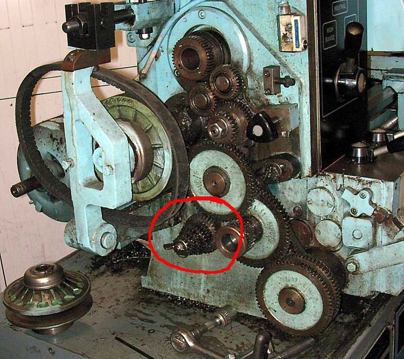

Your lathe has a gearbox on the front? With a round dial and a lever that you can set to N at the top or one of 5 positions? If so then the A-G gears are usually held on a stud under the end gear cover. If they are missing come back and let us know. Post up some pics of your lathe in any case.

Gear D doesn't do reversing, except that it sits on the tumbler reverse pivot. The tumbler itself does the reversing. What the lettered gears do is allow you to cut the full range of threads as shown on the front of the gearbox.
Look at the gear cutting chart. You'll see letters in the boxes along the top. The threads below the letter D are the ones you can cut right now with your one change gear. On a metric machine that means 1.0, 1.5, 2.0, 3.0 of the common-use thread pitches. For 1.25 and 1.75 you'll need a G and for 0.8 you'll need an A.
It's a shame your gears are missing, they are usually kept on that stud.

The spare gears should be stored on a bolt inside the gear change cover. Are you sure that they are not there?

Just in case you really don't have them, here is the full drawing set for getting new ones made. This is for the metric lathe.
ML 115 metric gearbox stud gears a to g.pdf
(2.34 MiB) Downloaded 620 times

All the info is there in the PDF Walid. I guess you were typing your reply when I was posting it.

Original gears are just normal mild steel. You'd have to be careful with plastic gears but they might get you out of trouble. You could keep the steel D gear on there most of the time.
Do you have gear cutting equipment?

You can't do metric-inch or inch-metric by just changing the stud gears a-g, you need compound gears like 127/100 or 127/130 in the train. There's a lot of info about on it but basically the answer to your question is no.
