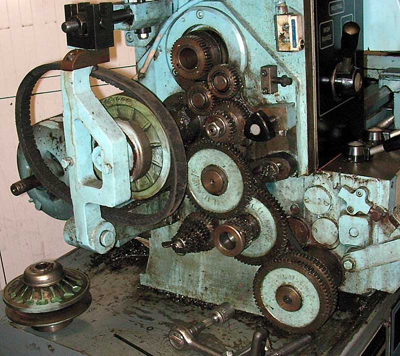

Post by Pete. » Sun 30 Jan , 2011 17:10 pm
Here is what the end cluster of the gearchange looks like within the cabinet, for your reference. Your should be identical (except of course for the motor and pulleys).
