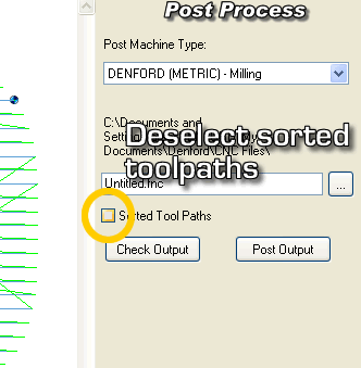

- * IMPORTANT *
In the post output screen, make sure the sorted tool paths option is turned off before posting the CNC G code file. - cut-one-way-4.gif (13.96 KiB) Viewed 5421 times

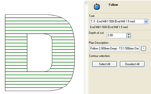

- Select the follow machining plan and choose the hatch lines previously created
- cut-one-way-3.gif (14.78 KiB) Viewed 5421 times

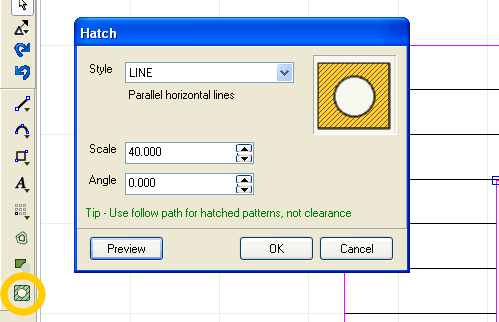

- Create hatch lines with the hatch tool. You will need to experiment with the scale value in order to get the distance between lines you require (ie tool stepover)
- cut-one-way-2.gif (12.23 KiB) Viewed 5421 times

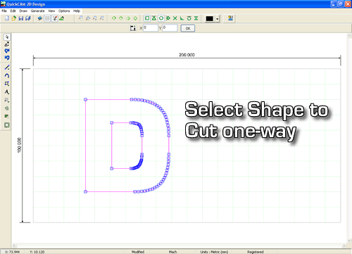

- Select the shape you want to raster across in one direction
- cut-one-way-1.gif (23.51 KiB) Viewed 5421 times
