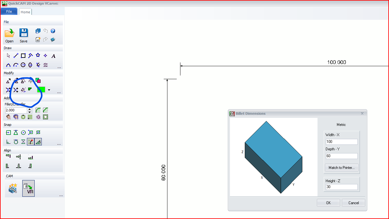

Re: Is it possible to trim lines?
Posted: Thu 16 May , 2024 11:49 am
by Steve
The trim feature is now standard in V2 of QuickCAM.
You still have to explode objects to be able to trim them.
